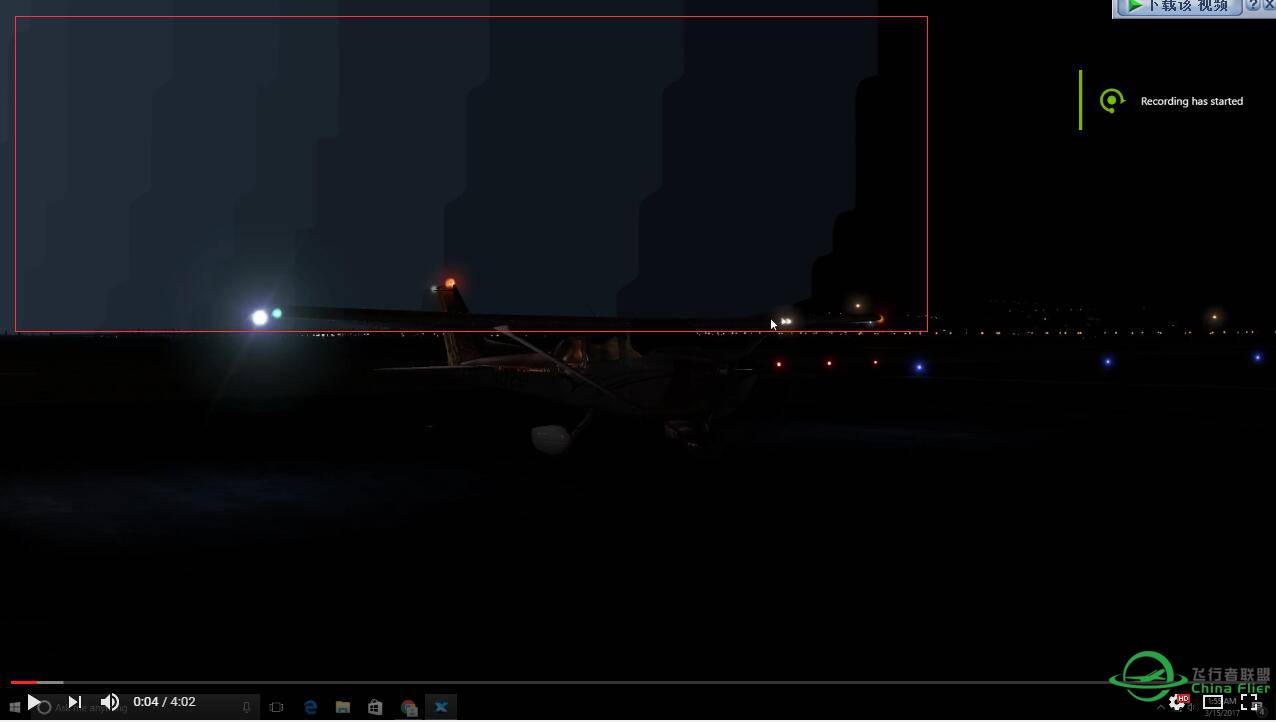

Glare就是下面红框的样子,据说到PB15都还没有修复,大家都挺着急,有个小哥给出了一个解决方案,大家看看有没有效果:
干掉XP11的黑夜的glare!-8376
原视频地址:https://www.youtube.com/watch?v=H3_acSkqdls
原文:
Finally, here it is. The permanent fix for killing the night glare. You will not have to do it using the dataref editor everytime you spawn in X Plane 11. Here are the steps as usual:
Flywithlua download link: http://forums.x-plane.org/index.php?/...
Step 1: Download flywithlua with the download link given. Please login to xplane.org to download the file.
Step 2: Copy the flywithlua folder to x-plane11/resources/plugins/
Step 3: Make a .txt file and write out set("sim/private/controls/dome/kill_glares", 1)
Step 4: Rename the .txt file to .lua file as shown in the video.
Step 5: Spawn anywhere in X Plane 11 and check the skies. DONE!!
Step 6: Stop lua engine to get rid of the messages on screen. Refer the manual for more information on flywithlua. It comes with the download.
实际上还是利用一段lua代码来实现,具体步骤:1.下载Flywithlua,并解压到x-plane11/resources/plugins/
2.然后在Flywithlua的Scripts目录下建立一个txt文档,并输入
存盘,并将扩展名改名为lua3.运行XP11,检查效果,如果屏幕上的文字太多,可以Stop lua engine 。(效果应该还在)。
如上,有请喜欢夜景的盆友试试。

等正式发售就好了,这是已知bug,在官方的修复列表里

我现在也有这个问题,不知道该怎么解决,都说XP11的夜景效果好,结果有了这个东西,真是大煞风景!
