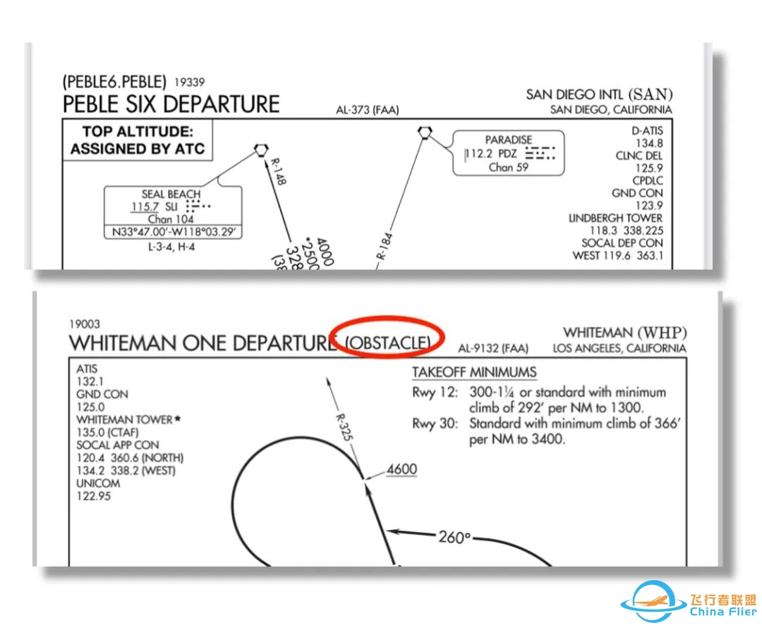

TYPES
There two types of DPs:

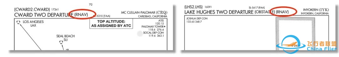

Basically, there two types of DPs: Standard Instrument Procedures(SID) (标准离场程序) and Obstacle Departure procedures (越障离场程序).
The graphically printed ODP usually has an “(obstacle)” in its title, which is distinguish to a SID.
There are three main types of SIDs: pilot-nav SIDs, radar vector SIDs, and hybrid SIDs.
A pilot-nav SID is a SID where the pilot is primarily responsible for navigation along the SID route. It allows for the aircraft to get from the runway to its assigned route with no vectoring required from air traffic control. They are established for airports where terrain and related safety factors dictate a specific ground track be flown.
A radar vector SID is used where air traffic control provides radar navigational guidance to a filed or assigned route or to a fix depicted on a SID. Flying a vector SID may require first flying an obstacle departure procedure (ODP). This is usually annotated in the ODP section stating, “Fly runway heading to xxx prior to making any turns.” Vector SIDs give air traffic control more control over air traffic routing than do pilot-nav SIDs.
A hybrid SID is a departure that combines elements of both the pilot-nav and radar vector departures. A hybrid SID usually requires the pilot to fly a set of instructions, then be vectored to a defined route to a transition to leave the terminal area.
PHAK 云端课堂 & 训练手记 | Departure Procedures-2458
1.Standard Instrument Departures(SID)  which is always printed graphically.
2.Obstacle Departure Procedures(ODP) which is printed either graphically or textually.
All DPs, either textual or graphical, may be designed using either conventional or area navigation(RNAV) criteria. RNAV procedures have “(RNAV)” printed in the title.

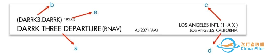

PHAK 云端课堂 & 训练手记 | Departure Procedures-6426
Tittle
PHAK 云端课堂 & 训练手记 | Departure Procedures-4023
a. The name of this SID chart. This SID is named “DARRK THREE” and designed using RNAV criteria. In general, “DARRK” is where the departure route ends.
b. The computer coded name of this chart.
c. The airport where this departure procedure is executed. The “LAX” is the ICAO code of the airport which omits the country code “K”.
d. The location of the airport where you execute this departure procedure. It consists of the city and the state.
e. The latest revision day, the first two digits “19” indicate the year “2019”, the last three digits indicate the day of the year.

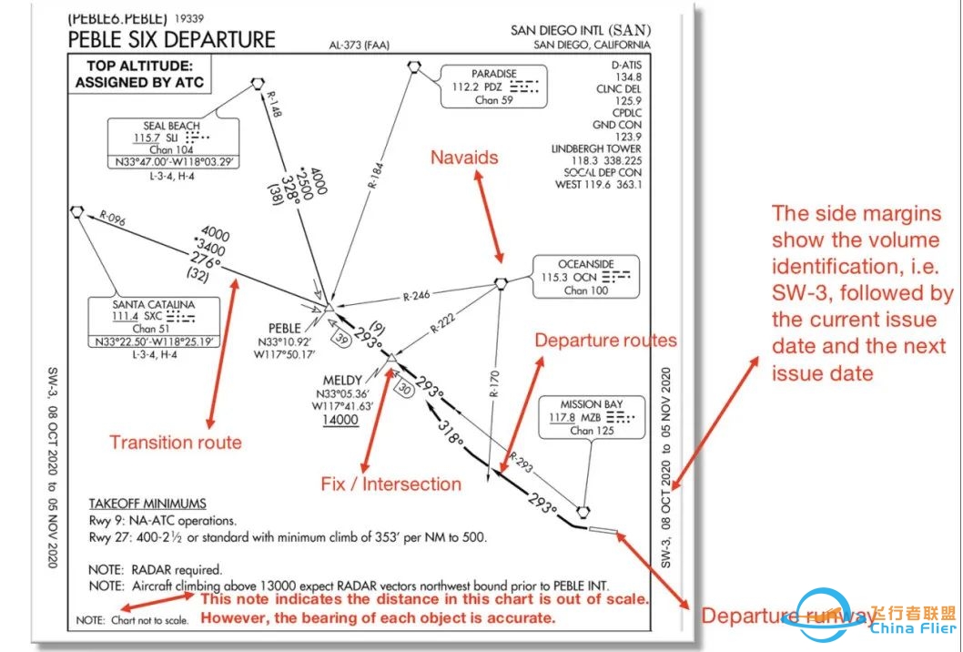

Graphic part
PHAK 云端课堂 & 训练手记 | Departure Procedures-2342
This is an graphic part of a typical SID chart which is designed using conventional criteria. You can see that there is quite a few information in this part. Generally, you can see the information of the control frequencies, navigation aids, different kinds of routes, fixes, waypoints( RNAV ) and takeoff minimums etc.

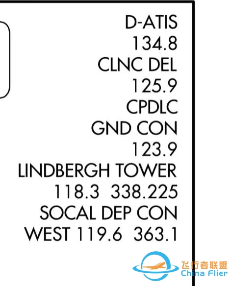

Radio frequencies (通信频率)
PHAK 云端课堂 & 训练手记 | Departure Procedures-2313
The communication frequencies are showed on the right top of this example.
Here provides some useful frequencies which you may need to contact when you execute the procedure. In this chart, frequencies of D-ATIS (Departure ATIS), CLNC DEL (Clearance Delivery), CPDLC GND CON (Controller Pilot Data Link Communication Ground Control), LINDBERGH TOWER…… are given out.

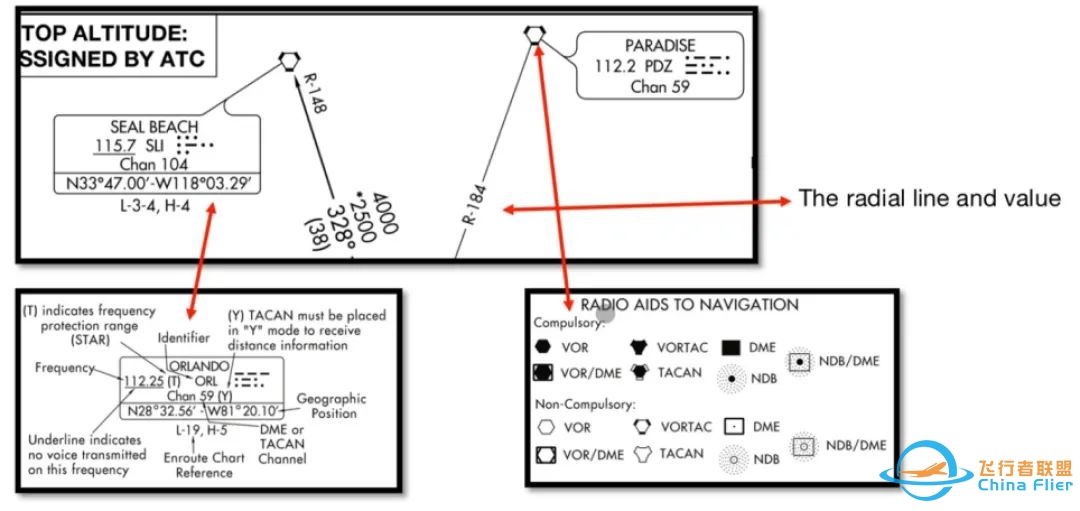

Navigation aids (导航设施)

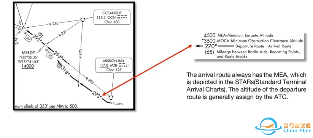

There are various navigation aids such as VOR, NDB, VOR-DME and VORTAC shown in the chart. It is crucial to be familiar with each symbol of these navaids.
As is shown above, you’re supposed to climb and turn right heading 293˚ and cross OCN VORTAC R-170, and turn right heading 318˚ to intercept MZB VORTAC R-293……while conducting this procedure.
PHAK 云端课堂 & 训练手记 | Departure Procedures-5251
Routes
Departure/Arrival Route (离场航路)
PHAK 云端课堂 & 训练手记 | Departure Procedures-1310

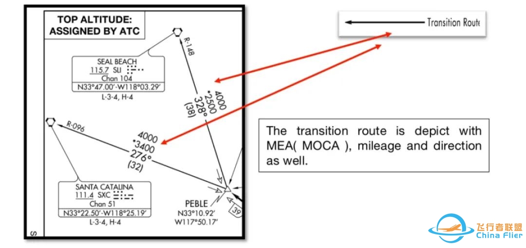

Transition route(过渡航路)
PHAK 云端课堂 & 训练手记 | Departure Procedures-3891

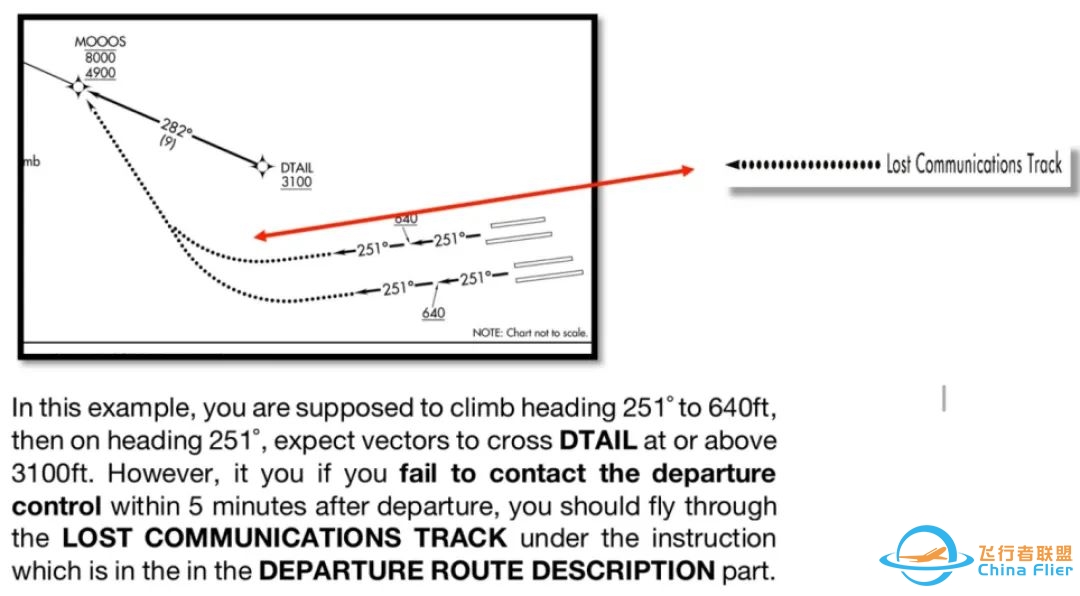

Lost communication track(通信失效参考航迹)

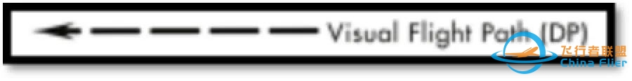

Visual flight path(目视飞行航路)
PHAK 云端课堂 & 训练手记 | Departure Procedures-3223
Copter DPs may also include a visual or VFR segment. Visual segments are depicted using the dashed line symbol above.

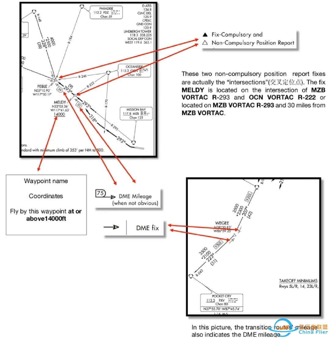

Fixes and Waypoints
    Fixes(定位点)
PHAK 云端课堂 & 训练手记 | Departure Procedures-1070

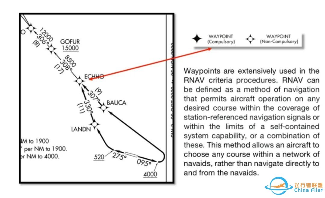

    Waypoints(航路点)
PHAK 云端课堂 & 训练手记 | Departure Procedures-8806

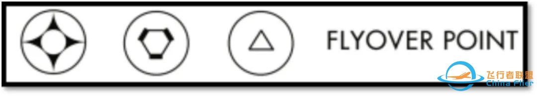

Flyover fixes
The fixes and way points shown above are the flyby point. The legends of flyover points which have a circle around them are shown below:
PHAK 云端课堂 & 训练手记 | Departure Procedures-4858
When the flyover point exist in your procedure, you need to fly over these points exactly before making any turns. However, when you are approaching a flyby point, you can make the turn prior to flying over the point to intercept another route.

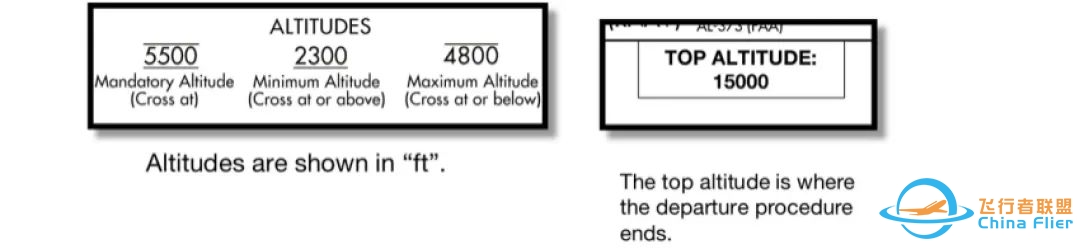

Altitudes
PHAK 云端课堂 & 训练手记 | Departure Procedures-1552

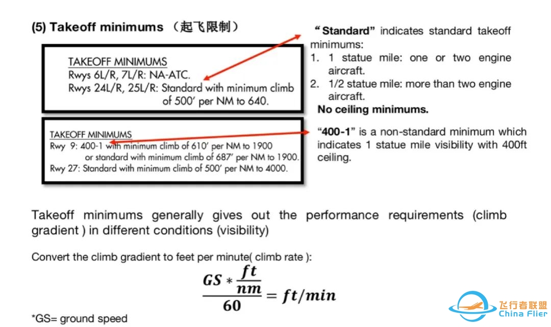

Takeoff minimums(起飞限制)
PHAK 云端课堂 & 训练手记 | Departure Procedures-5853

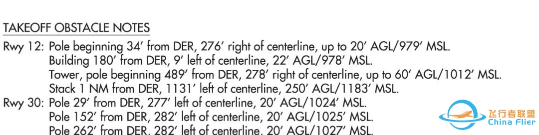

Note
PHAK 云端课堂 & 训练手记 | Departure Procedures-5718

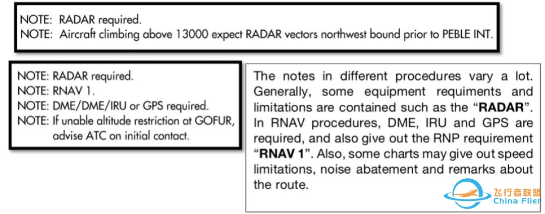

In obstacle departure prodcedures (ODPs), the obstacle information are show in notes:
PHAK 云端课堂 & 训练手记 | Departure Procedures-8989
DER: departure end of the runway

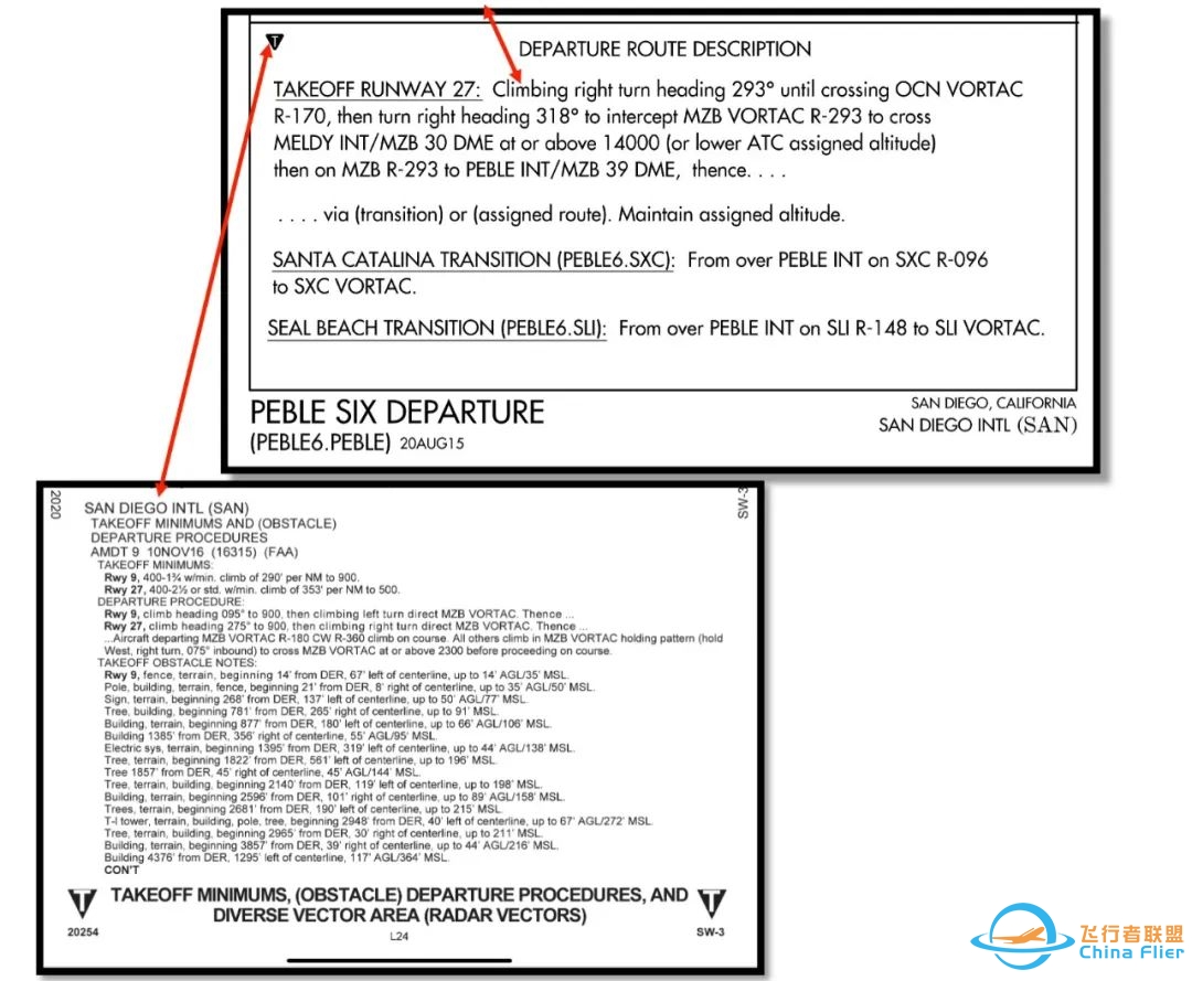

Departure route description(离场航路文字说明)
Route description just textually depict the departure route which is shown above. In some charts like the PEBLE SIX DEPARTURE, also specify that the first turn you make after takeoff is a climbing turn.
PHAK 云端课堂 & 训练手记 | Departure Procedures-4963
You can see there is a inverted solid black triangle with a letter “T” in it. This is the symbol of “takeoff minimums and (Obstacle) Departure ProcedureProcedures entry published”. This information of takeoff minimums is published in the “U.S. Terminal Procedures Publication” instead of charts.
In some charts, you are not able to fly to a designated fix/waypoint through a departure route. In this condition, you are supposed to receive a radar vector form the ATC. (see below)
PHAK 云端课堂 & 训练手记 | Departure Procedures-4151
If you fail to contact the ATC after takeoff, “LOST COMMUNICATION ROUTES*” are provided(See above). The description of the “LOST COMMUNICATION ROUTES” is also included in the Departure route description.

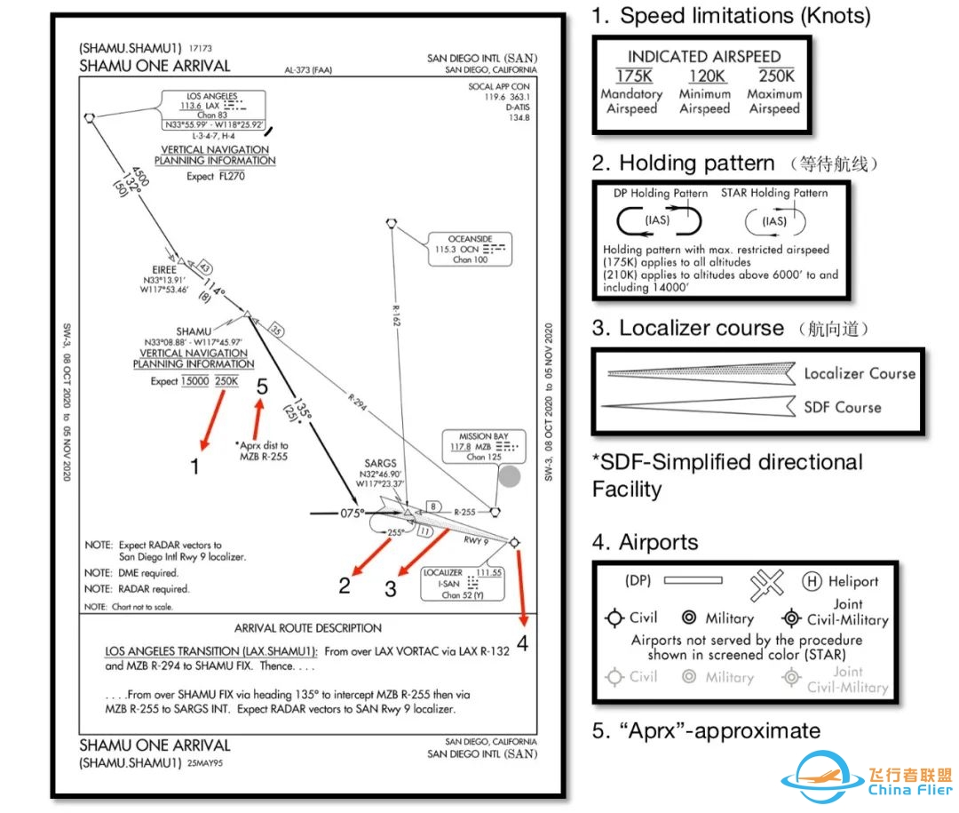

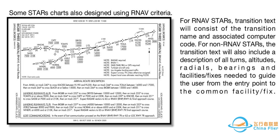

STANDARD TERMINAL ARRIVAL CHARTS
(STARs charts)(标准进场程序图)
STARs are pre-planned Instrument Flight Rule (IFR) air traffic control arrival procedures for pilot use in graphic and/or tex- tual form. STARs depict prescribed routes to transition the aircraft from the enroute structure to a fix in the terminal area from which an instrument approach can be conducted. STARs reduce pilot/controller workload and air-ground communi- cations, minimizing error potential in delivery and receipt of clearances.
The layout of STARs charts is similiar to the DPs charts, and most of the legends in the STARs charts resemble the DPs charts’. The STAR will show the arrival routing, including transitions from the appropriate enroute structure. All routes, turns, altitudes, NAVAIDs, facilities forming intersections and fixes, and those facilities/fixes terminating or beginning the arrival route shall be shown in the graphic depiction. A textual description of the arrival procedure is also provided.

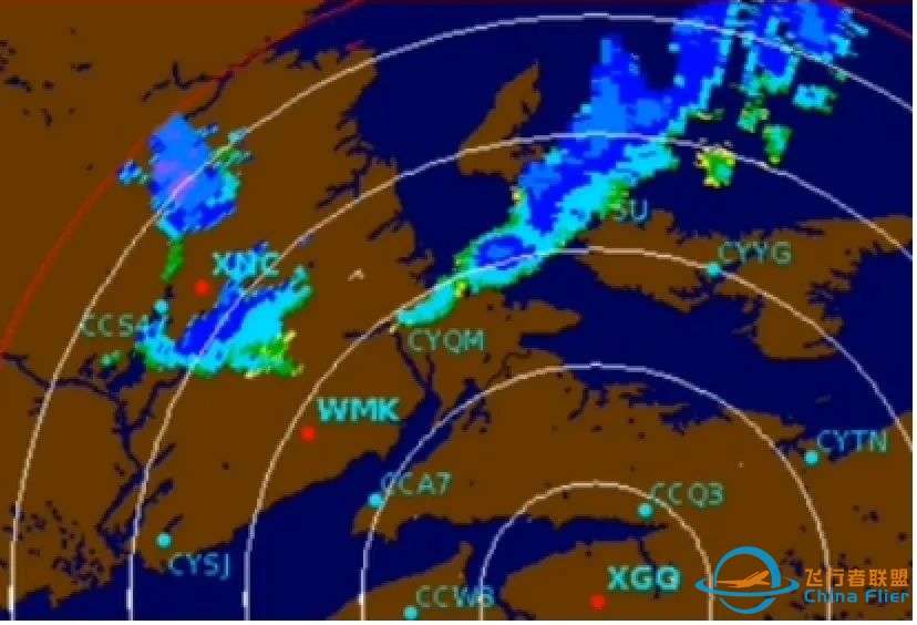

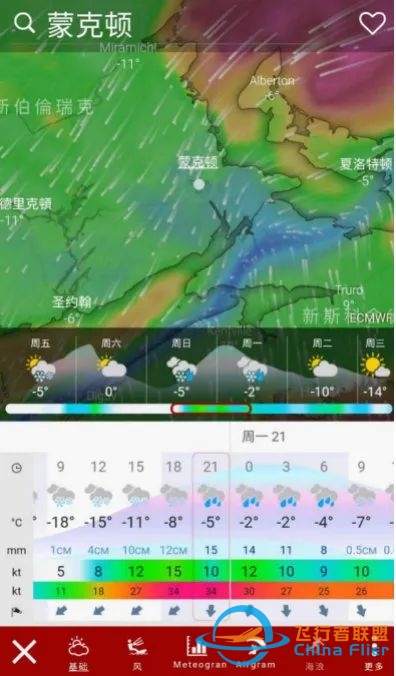

我们常说,飞行无小事,关于气象,印象最深刻的是 time building 时与同学的一次经历。

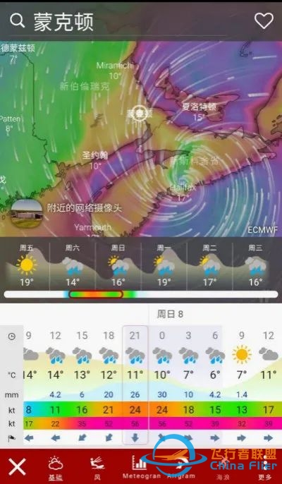

新不伦瑞克的蒙克顿地理位置靠海,天气多变,正值当时 time building 阶段,大家都在积极攒小时数,当时的天气雷达表示,蒙克顿机场北方较远处,有一块很大的云团,地面上看起来就像天边升起的一面墙,可当时值班教员分析,按照当时的风向风速,这块云并不会经过蒙顿机场,便给了我们授权,俗话说初生牛犊不怕虎,既然已经拿到授权,便同样相信一切尽在掌握之中,就这样起飞了,大概过了一个多小时,突然听到学校签派叫我们全速回机场,特别强调“全速”,就在对话结束的一瞬间看到了闪电!心里一惊,雷暴来了……当时飞的六块原始仪表的飞机,没有气象雷达,而夜间云朵没有了光源,也变为黑蓝色,很难注意到逐渐逼近的云块,当时离云体还有一段距离,但飞机仍然像失控一样地左摇右摆,突然上升又突然自由落体地颠来颠去,随即又是一条闪电,速度太快担心突然的风向变化会损伤机体结构,减速又怕比云体晚一步到达机场,眼看着降低的能见度,旁边同学出一后背汗,我俩心里其实又慌又怕却异常兴奋!一路狂笑还相互取乐,就这样一直飞到机场上空看到跑道心里才算有了底,下飞机后几个教练在签派等着还冲我们笑,“Good job for back!Unforgettable night!”
PHAK 云端课堂 & 训练手记 | Departure Procedures-291
图中CYQM即我们要返回的机场
后来才知道,机场北面的雷暴云突然分裂出几块小的,向蒙顿机场飘来,一个教员着陆的时候遇到强风切变,做出一个非常危险的着陆,下飞机后赶快叫回所有在训的飞机,我们便是最后一架,若是当时我们回来的速度慢一些,接近了哪块云体,或能见度过于糟糕,再者着陆时遇到同样的风切变,可能就是另一个故事了。
自然天气的多变,可能带来的危机程度不容忽视,学好气象,谨慎飞行,才是对自己安全的最大保障。另外,无论是实际飞行还是面试提问,如果发生了紧急意外情况,首先要做的就是操纵!操纵!操纵!保命最重要!如果有多余时间与精力,再去导航,通讯。
