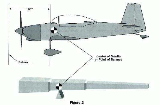

Weight and balance’s best analogy is a lever and fulcrum (think teeter-totter). If perfectly balanced on the fulcrum, the lever will be absolutely level. Adding any weight to the lever upsets the balance, and how much influence the weight has depends on its location on the lever. The greater the distance from the fulcrum, the greater the influence.
To regain the lever’s balance you must add some weight on the other side of the fulcrum (see Figure 2). The distance the weight is from the fulcrum is arm, and when you multiply the weight times the arm, you get the weight’s moment, or how much force it exerts (more on this later).

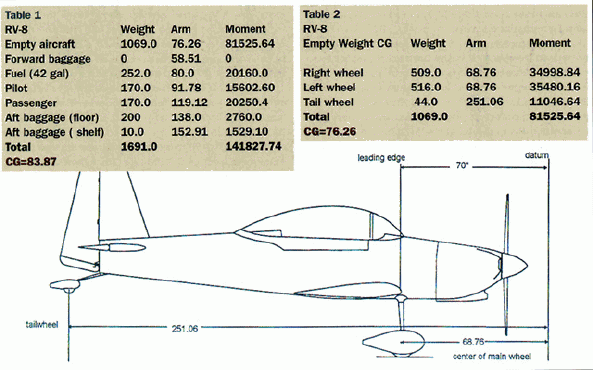

To make sure your airplane is in balance—that its CG is within its limits—you calculate its weight and balance for different configurations before flight to determine the CG’s location, mathematical proof that your airplane is properly loaded. Because you’re building your airplane, you will want to calculate several conditions to enable you to further calculate certain loads.
The weight and balance computations presented (Table 1) are for a typical RV-8, and the basic mantra for all weight and balance computation is: weight multiplied by arm equals moment. You fill in the spaces with the weights of the fuel, baggage, and occupants as appropriate, and then multiply them by the arm to get each item’s moment. (The empty weight, arm, and moment for your aircraft are constant, and you determine them when you weigh your homebuilt, which we’ll discuss next.)
To determine the location of the RV’s center of gravity, add up the totals of the weight and moment columns. Then divide the total moment (141,827.74) by the total weight (1,691) to get the CG’s location (141,827.74/1,691=83.87).
The RV-8’s CG range goes from 78.70 to 86.82 inches aft of datum, and 83.87 falls within the prescribed envelope. The RV’s maximum gross weight is 1,800 pounds, so 1,691 pounds is within that envelope. From these calculations we have mathematically proven our weight and balance data.

A good way to make sure you record all the required weights and measurements is to create a form like Table 1 or 2. When the required weights and/or arm numbers are filled in, you’re done—with weighing and measuring. Now it’s time to do some math. (To make life even easier, create the tables using a spreadsheet program, such as Microsoft Excel, so it will do the math for you. As an added benefit, you can use the spreadsheet to compute your airplane’s weight and balance forever. All you have to do is plug in the numbers for the variable weights like passengers and baggage.)
Weight and balance math isn’t hard if you remember the W&B mantra: weight times arm equals moment. Table 2 uses hypothetical numbers for the RV-8, and after you compute the moment for each wheel, you total up the weight and moment columns. To find the empty-weight center of gravity, reverse the W&B mantra: divide the total moment by the total weight. Doing this for the numbers in Table 2 tells us that the RV-8’s EWCG is 76.26 inches from the reference datum (81,525.64/1,069=76.26).
You may note that the EWCG falls outside of the RV-8’s established CG envelope (78.70 to 86.82 inches aft of datum), but that’s okay because the RV won’t fly without a pilot, fuel, oil, etc. The weights of these essential components will bring the CG inside the envelope.
